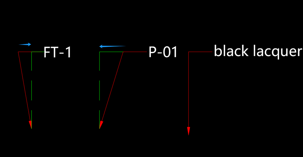

I have a lot multileader annotation and i was told to make all the leaders vertical. Is there anyway to make the come true easily, cause i have a lot of annotations. Thanks in advance😀

ВeekeeCZ
Easy with LISP.
http://www.lee-mac.com/runlisp.html
(defun c:Mleader90 ( / s i e d a b)
  (if (setq s (ssget "_:L" '((0 . "MULTILEADER"))))
    (repeat (setq i (sslength s))
      (setq e (ssname s (setq i (1- i)))
	    d (entget e)
	    a (cadr (assoc 110 d))
	    b (cadr (assoc 10 (member '(302 . "LEADER{") d))))
      (setpropertyvalue e "TextLocation/X"
	((if (> b a) - +) (getpropertyvalue e "TextLocation/X") (abs (- b a))))))
  (princ)

Richard_Yankee
Hi @ВeekeeCZ, Thanks for your kindly help, I really appreciate.
I tried the lisp, it seems only works for some of Mleaders not all of them. Could you please help to check what's going on coz  I'm not farmiliar with Lisp. Thank you so muchMleader90.gif
Message 5 of 9
ВeekeeCZ
Yeap, I can see that, thanks. That's all I can do with the picture.

Message 7 of 9
ВeekeeCZ
Ok, a different approach does that trick.
(vl-load-com)
(defun c:Mleader90 ( / s i c o)
      (and (setq o (vlax-ename->vla-object (ssname s (setq i (1- i)))))
	   (setq c (vlax-safearray->list (vlax-variant-value (vla-getleaderlinevertices o 0))))
	   (vla-SetLeaderLineVertices o 0 (vlax-safearray-fill (vlax-make-safearray vlax-vbDouble '(0 . 5)) (apply 'list (mapcar '(lambda (x) (nth x c)) '(0 1 2 0 4 5))))))))
  (princ)
To make them flat, change the number series to 0 1 2 3 1 5.

Both newer versions work great in the sample I shared. Thanks.
