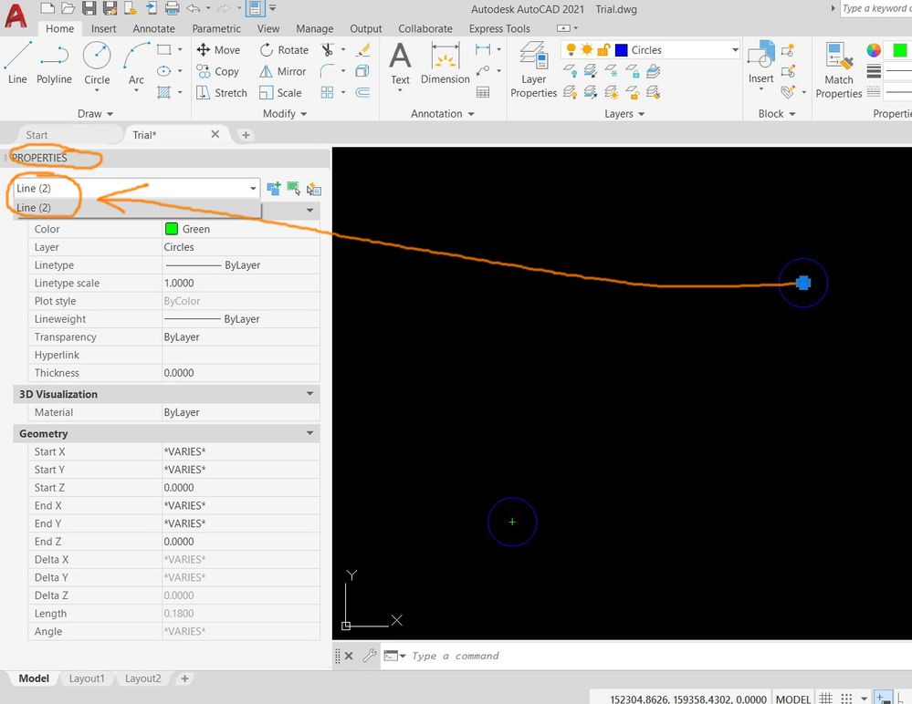

JamaL9722060
I couldn’t manage how to PERMANENTLY display the center of circles!
Jamal Numan
Message 15 of 21
Kent1Cooper
Read about the DIMCENTER command [which can put either a little cross at the center or also lines extending past its circumference, but they are not associative, so the resulting Lines are not "tied to" the Circle] and the CENTERMARK command [which makes associative ones, but apparently with the extending Lines -- it won't do only the cross in the middle].
Kent Cooper, AIA
Message 16 of 21
BillW435
I have the same issue, seeing center point of circle. Just having center osnap activated won't do it. But with center osnap on, if you click any of the Draw commands and approach the circle, center crosshairs appear and stay visible. This may be an awkward workaround, but works for me!
Message 17 of 21
JamaL9722060
Thank you Kent1Coope
I observed that the center is added as two crossing lines but not as a point. Also, the command doesn’t select multiple circles in one go
Jamal Numan
Message 18 of 21
Kent1Cooper
@JamaL9722060 wrote:
.... I observed that the center is added as two crossing lines but not as a point. Also, the command doesn’t select multiple circles in one go
Yes -- that's just how that command works.  A routine could easily be written that would use Points instead, and allow multiple selection, if you like.  The results, as with DIMCENTER, would not be associative the way the CENTERMARK's results are [i.e. if you Move the Circles, the center Points wouldn't go with them].  Something like this [in simplest terms, untested]:
