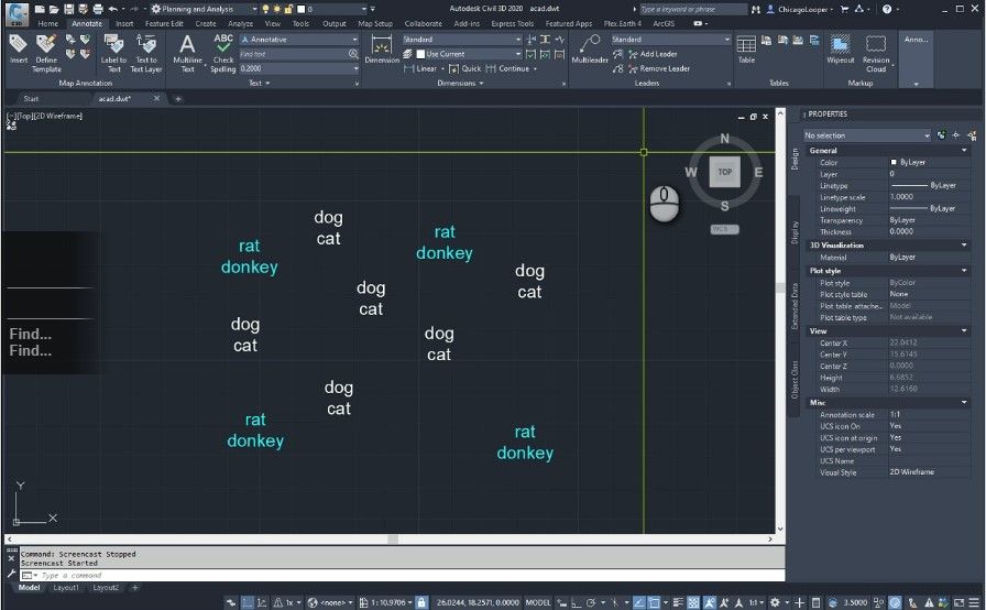

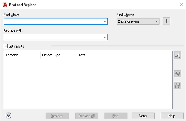

iCs-tna
I guess you misunderstood
by using the command find/replace I want to replace a multiline text by another multiline text.
e.g. I have 10 mtext with a MTEXT "dog cat" and I want to replace it with "mouse bird":

Message 6 of 12
Valentin_CAD
@iCs-tna ,
This is only possible if there is no ENTER or BREAK between the words.
Emilio Valentin

ChicagoLooper
Yes, you can use FIND command to search for dog cat,then once found, replace it with mouse bird. Here's a video that demonstrates how it's done.
To watch the video, click >>HERE<<.
