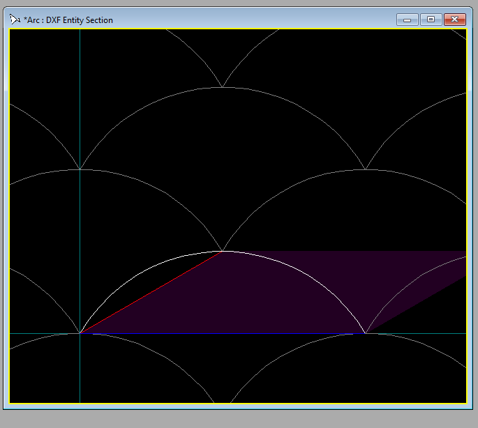

hugha
Try the pattern contained in the attached file.
the pattern was created directly from a WBLOCK'd  DXF of the seminal arc, arranged on a skewed mesh..
hth,
Hugh Adamson
