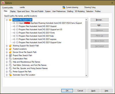

"...loading up pdf's from a certain directory. How can I modify the command string to change SamPesiridis as the username to default to individual username profile..."
If the path to the PDFs is the same for everyone except for username, then consider placing that path in the Support Files Search Path for all users and then removing it from the tool macro.
Message 6 of 9
9111965
Thanks for your response dmfrazier, but I'm not sure what you mean. Should I place the C:/Users/SamPesiridis/...... etc. in other users Support File search Path in Autocad?? If so, I don't have administrative rights to include that path. Then you mention remove it from the tool macro. How will it then load the pdf?? The problem is my tool palette command string I think. Explorer opens the pdf using my userprofilefolder and when other uses try and open that pdf using the tool palette key, this is the message they get.
PM Design Pty Ltd is the companies Onedrive folder where all my tool palettes and pdf's are shared.
Is there a command that will overwrite my userprofilefolder in the tool macro to theirs???
Message 7 of 9
dmfrazier
Honestly, I don't know if this will work, but "in theory" it seems that it should work.
"Should I place the C:/Users/SamPesiridis/...... etc. in other users Support File search Path in Autocad??
Sort of...
When a Profile is exported from one user's AutoCAD and then imported into another user's AutoCAD, any paths stored in the Support Files Search Path (SFSP) that point to user-specific folders and appear there with that user's username are actually not stored that way (in the Windows registry). They are stored (not visible to the user thru Options) as a replaceable parameter. AutoCAD "resolves" the variables for display in Options.
So, the first path in the image above is actually stored as %UserProfileFolder%\Appdata\etc., wherein the replaceable parameter (a Windows environment variable, much like an AutoCAD system variable) changes automatically based on the username of the logged in Windows user.
Unfortunately (or maybe it's fortunate), you can't enter the path this way in Options. It has to be done by importing a profile that was exported from a user that has the SFSP set up the way you want it. (Importing a profile makes changes to the Windows registry, which are then "read" by AutoCAD when it is launched. This is when the replaceable parameter is converted to an actual path.)

This part is where I'm stretching the theory a bit, because I have no previous experience with this particular type of macro. In AutoCAD generally, when filenames are referenced without explicitly stated paths, AutoCAD "looks" to the SFSP (or other paths stored in Options depending on the context) to "search" for the referenced file.
I know this works in several scenarios in AutoCAD, but I don't know if it works in the case of the type of macro you are dealing with.
