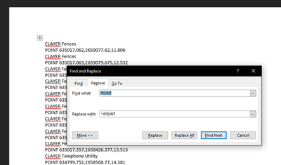

The main difference i made was adding another formula to excel. I added a CLAYER command and included the layer name
Then I copied all those lines into microsoft word and did another find and replace to insert a line break.
Once the line break was in place i copied all the lines of text (as they did in the link above) and pasted into the command line in AutoCAD.
This is the output.
I would caution that there may be a limitation on the number of lines you can paste into AutoCAD command (i dont know your the size of common data sets you will be working with) line so you may have to break up the lines you paste into chunks.
