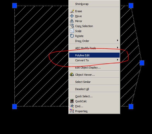

You click on the hatch boundary and right click, use polyline edit and add vertices.

If it's not, you can do it in the same way as grip-editing a Polyline -- select the Hatch, hover over a boundary grip, and choose your option:
You can either jump into that box and pick an option, or just type the first letter of the option you want.
If you want to Add a vertex, in the image it will add it "after" the current grip.  If you're not sure which direction the boundary considers "after" the grip you're on, pick the skinny-rectangle mid-point grip that's between the square end-point grips that you want to add one between.

Hi @Kent1Cooper & @Patchy
Thank you so much, I got it.
