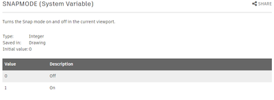

Apparently, I turned on SNAPMODE which causes the behavior shown within tables.
cfandrich
I don't think you accidentally turned Snapmode on. I had this start happening to me randomly and luckily found your issue post. I did not turn this on, and using the command fixed the issue. I think it's a bug in their system. For those who have this happen. you need to type in SNAPMODE, hit [Enter] and then type 0, hit [Enter].
jdukesJE67H
Snap mode is very easy to accidentally turn off and on though unintentionally since it is bound to CTRL+B. When I am getting a bit copy and paste happy, I have hit CTRL+B when I meant to hit CTRL+V.
By typing out SNAPMODE and setting the system variable to 0, you are turning it off.
In any case, glad you figured it out!
