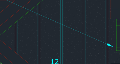

Hi everyone, I am tired of drawing individual lines and hatching in between them for this pattern.  Does anyone know how to code this to create this pattern?  This is basically a 1.5" wide board over a stucco finish that I use AR-SAND to fill in between.  I have the code for the boards, but cannot figure out how to add the AR-SAND to the code without it filling the boards as well.
Here's the code for the boards:
Thanks!

A dynamic block might be morer efficient for the purposes of others working with it too.
Message 3 of 12
Kent1Cooper
If you can bring yourself to lose one of the advantages of a Hatch pattern, you could EXPLODE the batten pattern, so its elements become the Lines you would otherwise have to draw, and then do the sand Hatching.

Randy, would a DB allow for an irregular border?
Message 5 of 12
dhumbertXE4R3
Kent, that is a good alternative idea if we cant get the hatch to work as I am envisioning.

Try the attached pattern derived from a HatchKit Stretcher Brick QuickFill template set to create a randomly dotted 14.5" wide brick @ 16" centres,  edited to an indefinite height.

Here's something that uses AR-SAND's lineset angles and dot spacings as a starting point, massaged to leave the batten strips empty and further to look reasonably random.  The not-quite-as-randomness of the look is because in order to not "bleed" into the batten strips, everything needs to have offsets that result in vertical alignments.  I had to do four or five lines at each angle to do "groups" of dots, because of the limit of 12 specifications per line.
*StuccoBatten16, stucco random dots with 1.5" un-dotted vertical battens @ 16"
37.5, 1.5,0, 1.123,1.46352209, 0,-1.52,0,-1.7,0,-16.94755862
37.5, 5.25,0, 1.123,1.46352209, 0,-1.52,0,-1.7,0,-16.94755862
37.5, 9,0, 1.123,1.46352209, 0,-1.52,0,-1.7,0,-16.94755862
37.5, 12.75,0, 1.123,1.46352209, 0,-1.52,0,-18.64755862
7.5, 1.75,.25, 0.33795196,2.567, 0,-.82,0,-1.37,0,-13.94806337
7.5, 5,0, 0.33795196,2.567, 0,-.82,0,-1.37,0,-13.94806337
7.5, 8.25,-.25, 0.33795196,2.567, 0,-.82,0,-1.37,0,-13.94806337
7.5, 11.5,-.5, 0.33795196,2.567, 0,-.82,0,-1.37,0,-13.94806337
7.5, 14.75,-.75, 0.33795196,2.567, 0,-16.13806337
-32.5, 1.5,.5, -1.0690039,1.678, 0,-.5,0,-1.8,0,-16.62102476
-32.5, 4.75,.25, -1.0690039,1.678, 0,-.5,0,-1.8,0,-16.62102476
-32.5, 8,0, -1.0690039,1.678, 0,-.5,0,-1.8,0,-16.62102476
-32.5, 11.25,-.25, -1.0690039,1.678, 0,-.5,0,-1.8,0,-16.62102476
-32.5, 14.5,-.5, -1.0690039,1.678, 0,-.5,0,-18.42102476
-42.5, 1.15,.75, -2.45393488,2.678, 0,-.25,0,-1.18,0,-20.27146728
-42.5, 4.4,.5, -2.45393488,2.678, 0,-.25,0,-1.18,0,-20.27146728
-42.5, 7.65,.25, -2.45393488,2.678, 0,-.25,0,-1.18,0,-20.27146728
-42.5, 10.9,0, -2.45393488,2.678, 0,-.25,0,-1.18,0,-20.27146728
-42.5, 14.15,-.25, -2.45393488,2.678, 0,-.25,0,-21.45146728
90, .75,0, 0,16
90, -.75,0, 0,16
If you save it in a file by copy/paste, rather than using the attached one, remember to include the blank line at the end.

Yes, that is one of the benefits to using dynamic blocks. I started putting one together but had difficulty using the dynamic array with the geometric constraints. Take a look at my screenshot, I think you'd need to replicate the batten/hatch (with the the constraints shown) to use as lookup/visibility objects. A little daunting if you've never used dynamic blocks but worth the exercise to learn.
I prefer not to create custom linetypes and hatches if I can.
The DB shown would do any trapezoid or triangular shape, you'd need to insert the block twice for anything more complex.

Hate to admit it but I am a 72 year old architect, self-taught AutoCAD user and still learning. I have spent a number of hours trying to create this code and yours worked. By studying your code I expect I will understand why it worked instead of what I saw on all the other forum posts.
My thanks,
