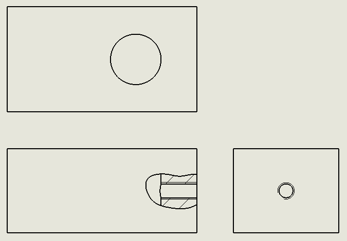

Hello. I am using AutoCAD 2017 and Inventor and solidworks.
I want to get the broken-out section view in layout when I working with imported 3D model. How can I get that? Recently I found some advantage of layout tabs, and I want to all mechanical drawing documentation work in AutoCAD.
(Attachment is just a example.)

How can I modify the view's shape? that is the problem.

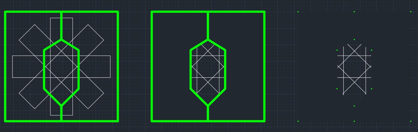

elshawadfy
Hi @Anonymous,
You can use 2 wipeouts.. see the pic.,
1- first I created 2 polygons completing each other (pic-1),
2- Then I applied wipout, p for polygon, e to erase the original polygon.. (pic-2)
3- I then changed the line type to a dotted one and gave a very high line type scale (10000).. as tu can see only dots appear in the corners.. (pic-3)
See the attached dwg..
