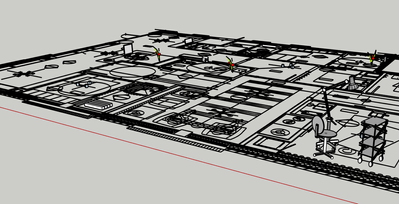

I'm trying strip this DWG down to just the floorplan (hopefully preserving casework locations), BUT I cannot seem to export it in any form and keep the interior walls. Everytime I try to import into Sketchup, the interior finished walls are missing. I see they are on their own layer.  I am trying to delete some of the furniture and fixture items.
Any help would be appreciated. Thanks.

I started by running Audit, Purge, and -Pur>Regapps on your DWG file. I then ran Exporttoautocad.  Lastly I saved to 2013 format.
Let me know if this works for you.
