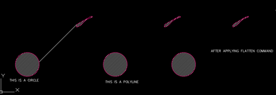

Can anybody tell me what is causing the hatch on the left in the attached drawing to glitch and show a line between the two objects?  If cut a little piece out of the circle then close it so it becomes a polyline, it doesn't do it anymore.  I have plenty of workarounds, I'd just like to know why it is happening so I can avoid the situation.

It's something wrong with that top polyline.  Here's the same polyline interacting the same way with another one.  What is wrong with it?
paullimapa
After applying FLATTEN command:

Hmm, still doing it after using flatten for me.  What made you think that would help when neither of the objects are away from z=0 or 3d?  And why did it work for you and not me...
paullimapa
Typically when odd things happen with objects I would run the FLATTEN command.
I'm not sure why that didn't work for you though.
Did you open the dwg I posted to see if the Circle & Pline objects on the far right still works for you?
If so, perhaps copy & paste those into your dwg & see if that still works.

We do the same thing here.  I got a routine called superflatten just because so much stuff we get from engineers has z coordinates all over the place.  Anyway, the file you sent back does work for me as it did for you, but I noticed that something happened to the polyline so that the one you were hatching is not identical to the original.  Mine is the pink one, yours is the yellow one.  I think that's why they're acting different from each other, not from being flattened.

The Flatten command could have made adjustments to that PLINE object.
But I also noticed something else that's odd.
When I open your dwg in AutoCAD 2020 the Hatch Preview still shows that line.
But once I complete the Hatch command the line disappears.
This odd self correcting behavior does not occur in 2021, 2022, 2023 or 2024.
But in all the other versions I would run the FLATTEN command actually on just the PLINE object and that resolved the issue.
