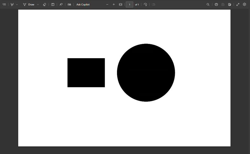

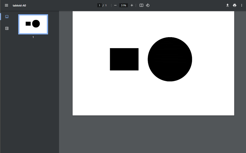

@nickLQFNV wrote:
...The screenshot is from Affinity Designer.
this is from FOXIT PDF EDITOR
This if from CHROME (yes, the browser)
From EDGE (yes, the other browser)
Adobe Acrobat (with these display settings)
@nickLQFNV wrote:
Do you know why this is still the way AutoCAD handles plotting solid hatches? I'm just curious.
See above FOUR sample, seems challenging to me anyway, you want to take a stab at fixing it for them?

In FOXIT, can you select the circle as a single object? I'm not concerned with the appearance in software, as there's workarounds for that. I would still like to be able to export a pdf with solid hatches that are a unified single object within their boundary, which would make later edits to the pdf easier. I'd prefer to be able to select one hatch instead of 50 narrow triangles.

@nickLQFNV wrote:
In FOXIT, can you select the circle as a single object?..
No. That's a limitation of your software with output from Autodesk. I suggest you try a different software for the task you want, Adobe Illustrator.
