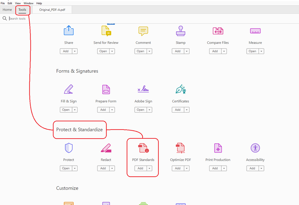

You cannot create PDF/A directly from Autocad but you can create one using a PDF creator. Please don't confuse a PDF-creator with a PFD-viewer. Do you have Adobe Acrobat? Or Adobe Acrobat DC? Or another version of a PDF creator?  Open your PDF using your PDF creator.
  1. Go to TOOLS Tab=>Protect & Standardize section=>PDF Standards Icon
2. Back in your PDF document, go to panel on the right, select 'Save as PDF/A.'
3. Choose your location to save, then click SAVE.
