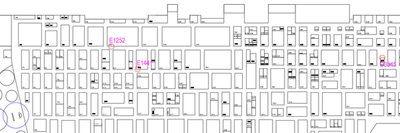

Hello Everybody,
Please, is there any way to generate automatically the dimensions of all rectangles in a drawing like the rectangle 1 (see pdf attached) instead of doing that manually for every rectangle.
Thanks!

olijbailey
Hi @Kent1Cooper
Thanks again for writing this script and sharing it. The problem is definitely with my drawing, which is unsurprising, given that I am not a CAD professional. Attached is an example. I don't know what I'm doing wrong. Dimension style perhaps? I seem to be able to successfully run the auto dimension script at close zoom levels but not when zoomed out. Ideally, I want to apply it to all polyline objects on the drawing in one go. There are no error messages or anything I can see that will give me a clue. Sorry. Once again, I appreciate your help.
Message 13 of 18
cadffm
My I ask for this .dwg and a view/zoom which works??
The issue are three Polygones with nonsensical form (vertex 4, area 0)
and the both blue marked rectangles with a side <= 2.0, which will fail
Sebastian

cadffm
@olijbailey wrote:
Right. I guess my point is that it does work at closer zooms. 0.000177, for example
No, it has nothing to do with zoom, just with your object selection
(while in zoom 0.000177 you NOT selected the same objects!)
As I tried to explain above in details, you have 5 Element what are invalid.
3 are nonsens, 2 are to small for the settings.
Take time, and delete the 3 objects and the 2 other ones: Don't select them (or edit the with to >2)
A close look to one the object (the most right marked):
And my I ask why you are wotking inside a viewport? Instead of the MODEL TAB
Sebastian
Message 17 of 18
olijbailey
Now I see it. Thank you. There were errant objects hidden underneath the rectangles in those instances!
