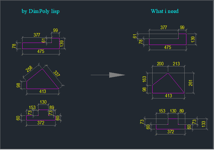

Your autolisp very useful, but if i only want to use your autolisp for only dimension line and no need dimension aligned, how i can modify it ? Thank you so muchUntitled.png

That's actually quite a bit more complicated than you might think, but probably possible -- I'll have to think about it.  In the meantime, the QDIM command can do much of what you want, though you'll need to run it four times on each Polyline, and it will make more Dimensions than in your image examples, because [for example] its left-side Dimension string will pick up vertices along the right side.  But if you can [even temporarily, and re-join later] Explode the Polylines into Lines, you could get QDIM to do exactly what you want.  And it has the advantage of not having extension lines overlapping orthogonal edges.
Kent Cooper, AIA
Message 12 of 31
Kent1Cooper
Looking at the image again, I have some questions.
You have a second overall Dimension on the right end of the bottom right figure, but no other overalls along sides with more than one Dimension.  I assume that's because there's no single  edge on either end of the figure to Dimension that overall height along.  It would be a serious challenge to figure out how to instruct a routine to determine that.  Is the overall Dimension something you would want the routine to draw, rather than putting it in yourself where needed?
Many of your strings of multiple Dimensions along the same side are continuous, but some are stepped.  Is that a matter of how crowded the text is between the extension lines on the ones that are stepped?  Again, telling a routine how to figure that out, and what to do about it, would be difficult.
Would you ever have a concave  situation such as this?
How should that be handled?
Not really a routine's problem, but a question of how you draw and how you define your Dimension Style:  I notice that the Polylines are not drawn with precision and the Dimensions are rounded, because [upper-right figure] 377 + 99 does not equal 475.
