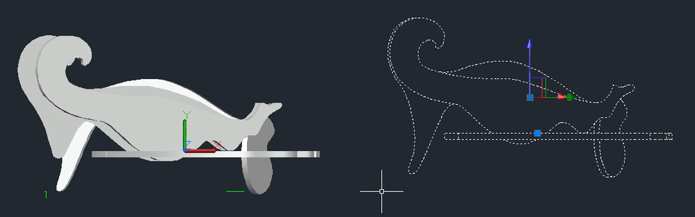

imadHabash
I try Flatshot and every this is going fine (see attached image)
I notice that there is an xref files attached,maybe xref files are the reason for failed operation.
Imad Habash

Alfred.NESWADBA
That are TIFF files, not drawings, so these are not involved in the _FLATSHOT command 😉

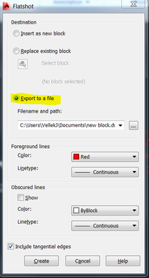

Hi @Karol-Or,
I too had no problem with FLATSHOT in AutoCAD 2017
I also tested in 2014-2016 without error.
Are you receiving any error messages?Are you exporting to a file? If so, is the file location accessible and do you have permissions to write data there?
