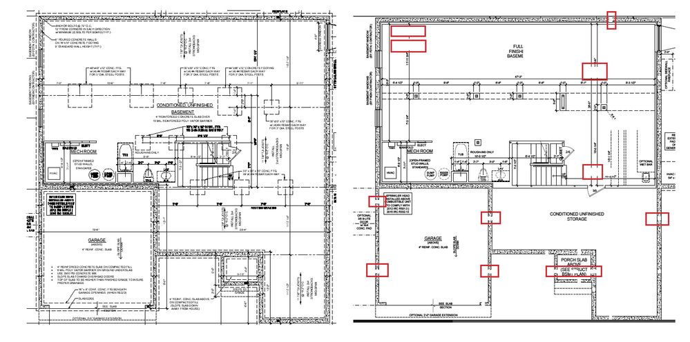

I have a layer turned off in the viewport for text needed on one drawing sheet but not for another.  The layer contains text with and dimensions with a background blocking for clarity in the drawing but for the viewport with this layer frozen, the block-out is showing and covering lines in the drawing.  I hope that someone can help and knows how to work around this.

Thank you.  I was out for two days sick but back now.  I attached the cleaned file.  It seems odd to me why dimension text background would show if the dim layer is turned off. (98-DimensionsBasement)

Ah, that's not the correct paperspace.  I looked more closely at your screenshot.  It's 4-3-1 where none of those pink dimensions should be shown (98-DimensionsBasement).  Also, on screen, things look okay but print preview and printing block out the walls, hatch, other dim lines...

The plan and paperspace that I'm having issue with is the set-up where those notes and exterior strings of dimensions are not on.  Most of them are not the issue.  You're showing the layout 4-2-1.

I'm sorry, I really don't understand.  I'm not trying to write anything sarcastically.  I'm showing you what I have on my end.  The drawing should show no exterior dimensions which is what I said that I think you were studying the other layout.  So I still don't understand what you mean.   I don't know what your screenshot means.  On your comments which ARE less than polite, I have to follow office protocol on how things are drawn and set up.

When the blocked out parts show up is that print preview or is that a PDF?
If you change PDF printers does it change?

Hello!   It is both in preview and PDF.  I will try playing with different print settings / cad settings and actual print too.  It seems really strange to me.

As noted by everyone touching your posted file with frozen-in-viewport-layers (aka nothing is OFF, off is not frozen), we seem unable to recreate your issue in preview or PDF output. Sorry.
Message 20 of 22
s60088g
Yeah, I'll need to look into print display settings and whatnot.  I've not had this issue before in 23 years of using Acad.  I do know that Frozen and Off are different but didn't see this as pertinent in distinguishing when having the issue of the background blocking out my drawing.  Regarding the plotstyle, this company has no plotstyle!!   No pen-settings set up to correlate to colors or otherwise.
