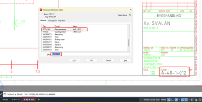

In the example below, the first drawing use field CTAB for attribute RITN_NR at one layout, the second at both layouts, and the third does not use fields at all.

@jreidKVSUZ In the example below, I have added three drawings (seen in the FILELIST_HEADER) and loaded the drawing stamp block PR1-T1. Each drawings has two layout, both containg a block named PR1-T1. For testing purpose, I have modifed drawing A-40-P-01_med_field.dwg to use Field/CTAB at layout A-40-1-011 (but not at the other layout). I have also modified drawing A-40-P-02_med_field.dwg to use Field/CTAB at both layouts. The drawing A-40-P-03.dwg is unmodified with original block definitions and regular attributes at both layouts. All files are saved in TILEMODE 1.

@jreidKVSUZ The three drawing are different for test purposes. As I described in one of my answers, the first drawing uses CTAB at one layout and a regular attribute at the other layout. The second drawing uses CTAB at both layouts and the third drawing uses regular attributes at both layouts. In a real world scenario, this would not be the case - I am just testing if our software displays any error under those mixed circumstances. It does not. I also thought this would better explain my problem! 😄.
If I copy the block from third drawing to second ditto, the attribute will be non-intelligent and I have to enter the drawing number manually. My intention is to populate the list automatically.
The drawings are saved in TILEMODE 1, why CTAB is Model and the list displays Model instead of the name of the actual layout tab.
My definition of regular attribute and attribute using field/CTAB:
Regular attribute - I have to edit the drawing number in the stamp manually
Attribute using field/CTAB - the value of current tab is picked up automatically and editing is disabled (unless editing the field). Right now in the image, the current tab is actually the tab where the block is inserted why it looks OK.
Indeed I could save in TILEMODE 0 and one of my layouts will display correct in the list. But the other layouts will display same value, as CTAB just has a single value.
