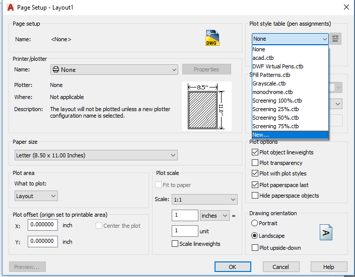

Hello @Anonymous,
What are the settings on your Page setup dialog box under Printer/Plotter?
  • Check another PC3 file, try a default type DWG to PDF or AutoCAD PDF then print
  • Update Printer Drivers
