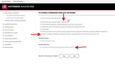

@Will_Nagelkirk Why not use FLATSHOT command instead of destroying your 3D generated original CAD file?

avishek.chakrabortyCSXPN
Thank you for bringing this question to the forum. From your description, it sounds like you’re working with a fairly complex drawing, and the long processing time and looping behavior you experienced after using FLATTEN suggest there may be a large number of objects or geometry in the file.
You might want to try a few alternatives instead of using the FLATTEN command:
  • Use FLATSHOT or SOLPROF to generate 2D views. (Note: FLATSHOT works only with surfaces or solids.)
  • If you need to replace Z values for 3D objects in a layout viewport, try this:
  1. Type OPTIONS on the command line.
  1. Go to the Drafting tab.
  1. Under Object Snap Options, check Replace Z value with current elevation.
Since you mentioned that FLATTEN takes a long time and sometimes causes AutoCAD to freeze, it may help to run it on smaller selections instead of the entire drawing at once.
Let us know if any of these suggestions work for you. If not, feel free to share more details about your drawing setup so the community can help you troubleshoot further.
