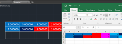

I'm using a table associated with a datalink to a range in the Excel spreadsheet. What I want is to have the background fill colour of each cell follows what's in the original Excel range. Something like the below left hand side. But the table in Autocad only reflects the font colour setting without the background fill colour setting (right hand side). How can I do this? Thank you very much!
Max

Thank you very much Alfred for taking time on your video - very easy to follow! I did exactly the same way. For Copy-and-Paste no problem. For Datalink way, initially it also worked. But after I change the background and refresh datalink in dwg, only font colour got refreshed. Background didn't.

I found that I can update the cell background colors too but not when there is the formula in the cell in Excel. I believe this is on the Excel file side. I tried applying the manual colors and numbers and then Un-protecting the cells. Now I can update the table in AutoCAD properly.

Yes, good news I also found out I could have what I wanted by properly setting up the datalink as follows:
Select "Use Excel formatting" & "Keep table updated to Excel formatting"
