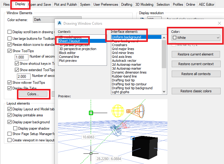

If you want the lines to appear black in layout I think you need to change the layout background color to white.  OPTIONS > Display tab > Colors > Sheet / layout > Uniform background > white

Okay, if your "paper" color in paper space (layout) is WHITE, then the linework appears BLACK.
But if your "paper" color in paper space (layout) is GREY or BLACK, then the linework appears WHITE. (this is why YOUR linework is white)
Color "7" in AutoCAD always behaves like this so that it doesn't get lost on various background colors.
If you want TRUE black with no exceptions, then use truecolor 0,0,0 - but understand that on a black (or even close to black) background, you will not see that geometry.
