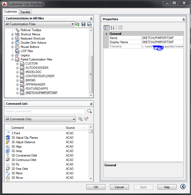

Thank you for your suggestion,
but when I check the 'partial customisation files' , there is no 'unresolved' extention as attached....

difficult for me 😉
The SketchUp-Plugin comes with a cuix, is this cuix reachable and loaded?
sketchupimportskp.cuix
Sorry, i can not explain all from here, thats a little bit too much.
Sebastian
Yes, it is loaded as attached.
Thank you.
