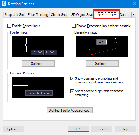

user181
@ahmed_tareq314  it is easier to change the dynamic input settings by using the DSETTINGS command and going to the Dynamic Input tab rather than changing the dynmode variable. You can visually see the settings available. After setting how you like just use the F12 key for on/off.
ahmed_tareq314
Thank you for such a tip! Using this dialog box feels much easier than dealing with system variables!
