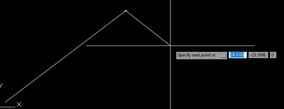

in reply to: Anonymous
Here is what I see with DYNIPFORMAT at 0
and this is what I get with DYNIPFORMAT at 1

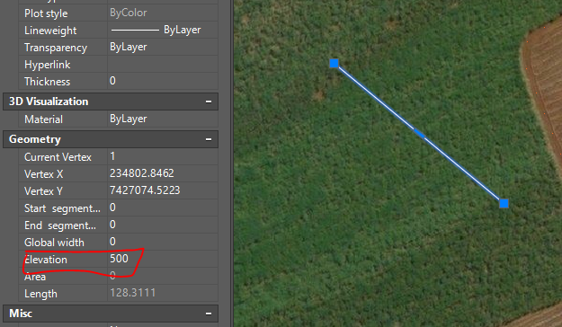

user181
The elevation of the line is 500 and if I change the value of elevation variable or the line elevation to any number I still get the results I've shown.  What are the values of your DYNPIVIS and DYNPIFORMAT and what are you seeing?
