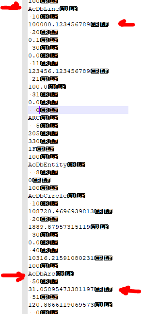

The database precision for real number is approximately 15 significant digits.  The units command controls how many decimal places of a coordinate are shown.  The displayed number is rounded to the number of decimal places specified by the units command.  AutoCAD calculations are based on the stored number not the rounded displayed number.
The following is a clip from the DXF file.  The precision you see in this file is not affected by the units command.  Note that the line coordinates show 16 significant digits and the arc start and end angle values (dxf codes 50 and 51)  do as well.

Coordinates, angles, and other real numbers (as opposed to integers) are not stored with a specific number of decimal places.  They are stored with a mantissa and exponent. The mantissa is limited to 56 bits and the exponent to 8 bits.  This yields approximately 16 significant digits of precision.   The user's setting for units has nothing to do with the number of decimal places for stored real numbers. In the sample DXF code in my post #4 the value 0.1 (after the 20) is the y coordinate.  The trailing zeros have been removed for ease of reading and you can assume the value is precise to 16 significant figures.

You are correct regarding DWG files and the way numbers are stored in the database. But when you save a drawing as DXF you can select the number of decimal places between 0 and 16.
See here for a comparison of 0 decimal places (left) vs. 16 (right).
As you can see in the screenshots every X/Y-coordinate and the bulge of a ARC vertex of LWPOLYLINE are cut off. But strangely the values of radii of CIRCLE and ARC are not cut off.
You can even try and reopen a DXF in AutoCAD after saving it with 0 decimal places. The coordinates are then set to the values from the DXF. The original value is lost!
This is a screenshot of a new drawing where I copied a LwPolyline from the original DXF with 16 decimal places (upper figure) and the "same" polyline from the "same" DXF with 0 decimal places (lower figure).

Still there is a very curious behaviour with different entity types. See the screenshots from my post above. X/Y coordinates are cut off as well as the bulge in a LwPolyline. But the radii of circles and lines are not cut off even when I select 0 decimal places.

>>"Still there is a very curious behaviour with different entity types.
>>"X/Y coordinates are cut off as well as the bulge in a LwPolyline. "
>>"But the radii of circles ... are not cut off even when I select 0 decimal places."
I think it isn't the object type itselve, but the the dxf code.
dxf 42 = not cutted/rounded
dxf 50 = cutted/roundet
>>"But ...   lines are not cut off even when I select 0 decimal places."
Lines?
dxf 10(20,30) 11(21,31)210(220,230) will be cutted
so i am not sure what you mean in case of "Lines"

Oops, "the radii of circles and lines" was supposed to be "the radii of circles and ARCs".
