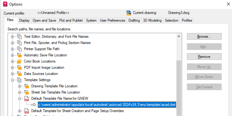

Why does my dwt drawing template look different depending on who opens it?

@cbpell29 ,
Check is everyone has the same template paths:
You each are using different DWT files.

Do this: open your DWT file, screenshot it, then use SAVEAS and call it something unique to you.
Have someone else who has a different looking/acting DWT to do the same, except the name of the file and screenshot is unique to them.
SHARE ALL FOUR SCREENSHOTs/ DWG FILEs HERE for someone to help you decipher the differences that you need to list in detail here when you can do that.

@cbpell29 wrote:
... look different ...?
What looks different?  For example, if it's just the drawing background color, that's a per-User setting, not tied to any file, whether DWG or DWT.  [OPTIONS command, Display tab, Window Elements area, Colors... button.]
