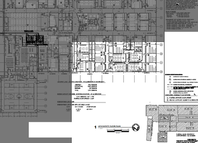

Hello experts,
I'm trying to export a DWG to DWF. I've been doing this for a while, but this is the first I have this issue and don't know what causes it. Please see the attached for clarification. Thanks in advance.

I thought it was because of the appilcations and computer, so I did restart them all and it's still an issue. I think it might be something from the overall plan because the overall plan is an xref DWF.

@ritztran Forgive me, but what are we supposed to infer from your screenshot? Let's rule out assumptions from everyone else other than you.

I tried to exported a DWF from AutoCAD Architecture 2022 in 30x42 paper. I usually have no issue with the exporting, but this time, the DWF is only highlighted a portion on the bottom right corner of the paper and shaded most of the sheet. The screenshot describes the issue.

@ritztran When you get a chance, instead of "export" use PLOT command, deliberately select the settings you need (I circled these for you in the image below) and see if your issue goes away

Thank you. I did figure out the solution by using plot instead of export. Thanks for your time. However, do you know why it happens that way when I use "Export".

If you want to use EXPORT exclusively it is best to make an effort to preset the desired settings using PAGESETUP command first (which coincidently loots a lot like PLOT command's pop-up).
