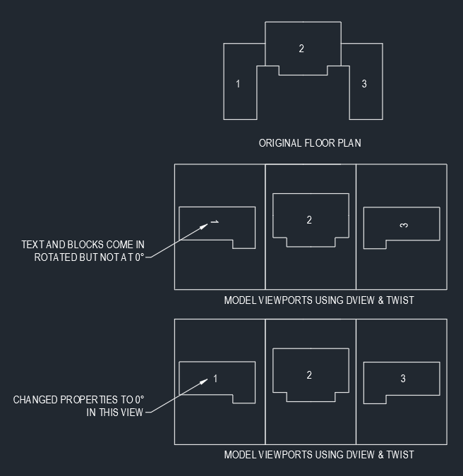

HI! I have been googling and trying everything... here's my question:
Is there a way to change the default insertion of blocks and text? I have a floor plan that is U shaped, and am doing electrical layouts. The two wings need to be horizontal, but I don't want to (if I don't have to) have multiple files for the same single floor plan.
My steps I've used using Google:
1. DView>TWist>270 (or 0 or 180 depending on the wing)
This changes the view perfect for each the three angles I want to work on, but blocks and text are still inserted at the default 0 degrees and look rotated.
2. UCS-World
Doesn't seem to make a difference (I don't know if I use this correctly)
3. Change the direction in UNITS dialog
The objects are inserted as if it were the default 0 deg, but properties show a different angle, say, 270. Then if I change the properties to 0, it looks exactly as I want it, text and attributes and all.
Is there a way to skip the step where I have to change the rotation in properties? Is there something else I should be doing or should I just give up and make several dwgs with rotated backgrounds and matchlines (ugh)?Capture.PNG

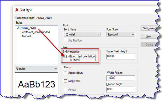

You can create a textstyle that is annotative and select "Match text orientation to layout"
Some input about annotative objects: >>>click<<<

Thank you! When I select this option in the style manager, it doesn't affect the blocks or new text in modelspace. Our blocks and text styles are all annotative and set per company standard. I have dynamic blocks with attributes using the same text style across the board. This option did make a difference in Paperspace though with a new viewport. I want to be able to do this automatically while I am working in the drawing in modelspace though. Blocks with attributes still come in at the "wrong" angle.

Yes, it will only work for those text and attributes that were set to be annotative and have assigned this new text-stye.
Have these attributes assigned the new text-style?
If no please make sure they do (including command _ATTSYNC so edit's in the block defintion are transferred to the block insertions)
If yes then please upload a dwg-file with that block insertions and let us know which version of AutoCAD you are on.

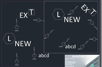

Alfred.NESWADBA
please find attached a dwg-file that shows you:
  • text in different rotated viewport views
  • blocks with attributes which are always horizontal, independent of the view rotation and block rotation.
- alfred -

AVieira12
Beautiful... this works perfectly. I'm having issue with our premade blocks though. I used your drawing and created a new block with text and attributes using your text style and it worked (this is the L Block)! Then I brought in one of our premade generic blocks (and removed some attributes and other info but thats all) and changed the text styles to yours, attsync... I tried redefining the block to also match orientation to layout but it keeps resetting to No... Any clue?
The new block is the hexagon with L, and premade is the square T.
Alfred.NESWADBA
just to make sure, you want the block to be rotated parallel to paperspace-X or just one attribute within the block?
Your "L"-block rotates itself, not just attributes ... that's different to what I did with my block.
- alfred -
Alfred NESWADBA
www.ish-solutions.at ... blog.ish-solutions.at ... LinkedIn ... CDay 2025
(not an Autodesk consultant)
AVieira12
Yes, I am also looking for the block to orientate as well as the attributes and text associated with it, much like my L block did so as to keep the shape at 0deg no matter what..

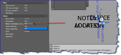

Alfred.NESWADBA
Well, sorry to say, but your blocks have dynamic content, and from what I see these types of dynamics blocks the block-definition to be set to automatically rotate to paperspace-X
This switch can't be set to "Yes" as long as you have dynamics inside the block. At least I don't get both together working, rotation to paperspace-X as well as having dynamics inside the block definition.
