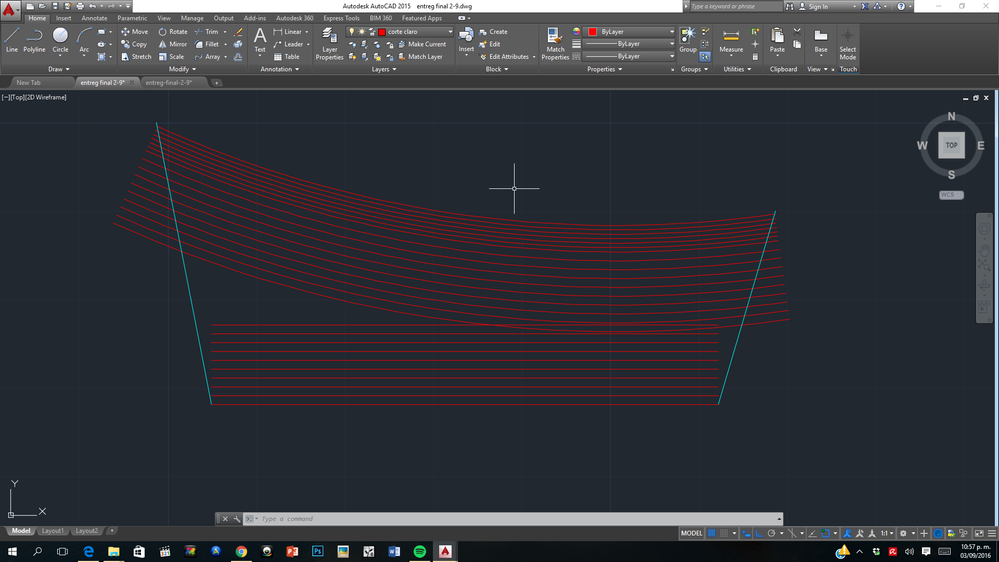

i need to draw multiple parallel lines between the red arc and the red line as its shown on the image.
when i do this with offset i get this problem.... what i need is a perfect transition, the rect line transfor into the arc.
thankss! and sorry for my english!

Looks like OFFSET command to me.
Message 3 of 12
the problem with offset is what i show on the second image!!! i need that lines start straight and end curved... and all this in a transition!!!!!

Am not sure about your query but from my end i have done something which may help you....i have done offset with multiple option and trimmed the unwanted entities. screen shot regarding the same is attached with
Message 5 of 12
thanks for your time! but the problem with that is that i need that at the end the lines touch the ground as straight line, as i draw in the images that i attached.

The transition from curved to straight would not allow the lines to be parallel.  A slight variation is required.  See sample.

It could be done with "almost parallel" arcs.  Divide the end lines, as well as a line connecting the two closest points between Arc and Line, by whatever sub-division you need (like 30 in my previous example).  Now use the Arc with 3 Pt. option, and snap (Node) to the corresponding division points.

You can try this lisp, see spoiler.

thanks!! thats what i need! but i dont undrstand what you do, you start with offset?? and then you modify end lines?

The routine automates the process described by @SEANT61 into a few seconds job.
