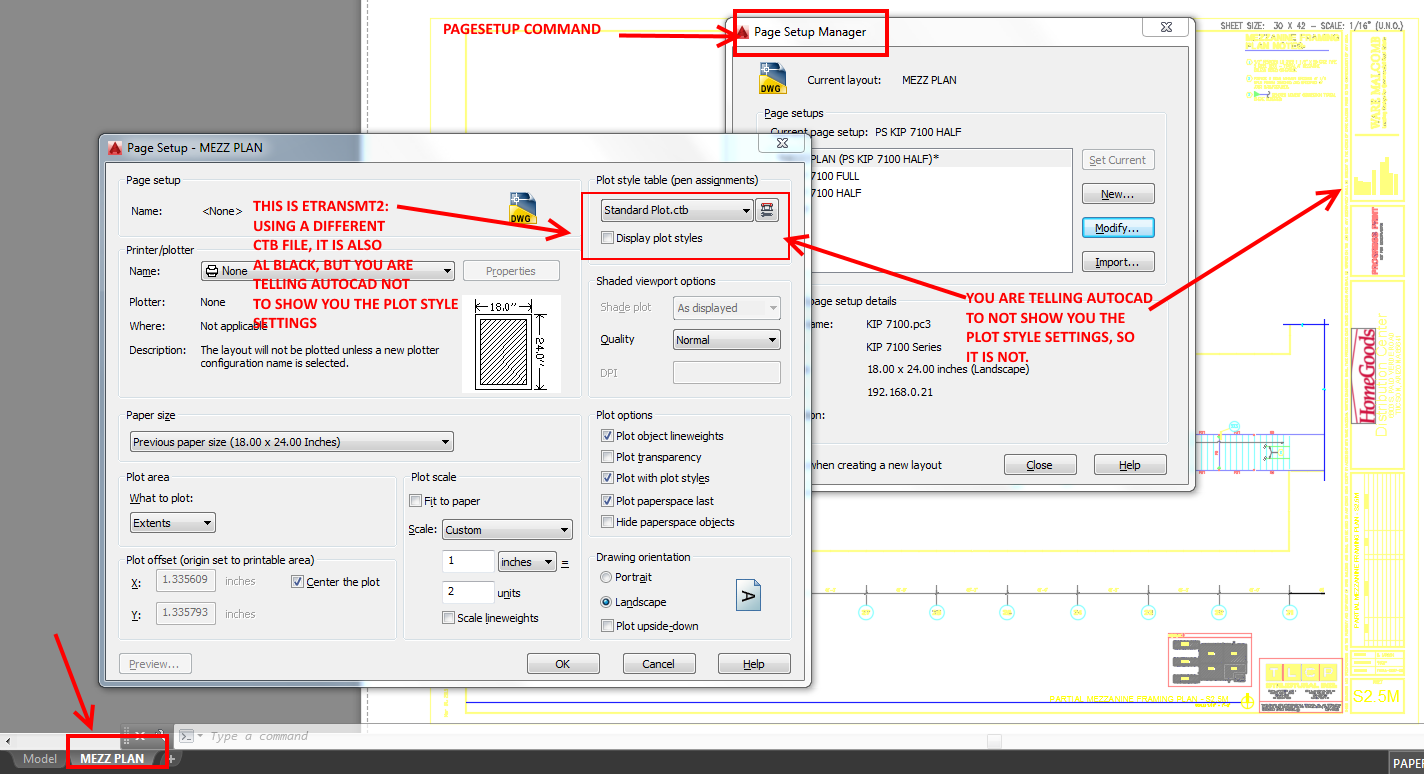

So in ETRANSMIT1, in the S2.6M dwg file's MEZZ PLAN layout, if I start PAGESETUP command is shows that you have 'display plot styles' box selected and you are using the HALF_SIZE.CTB file and you have that layout set to DISPLAY PLOT STYLES, that means your all black ctb file is going to show you the layout as all black. You told it to do so.
In ETRANSMIT2, there is a different ctb file being referenced BUT the layout is set to NOT display plot style tables.
Message 14 of 17

1. Nothing attached.
2. I changed that setting, close and opened your file several time and it does not reset all by itself.
3. You might need to change your base templates to disable the displya plot styles option so when you start with them moving forward those things are not on. You will need to modify your named paagesetups as well.
