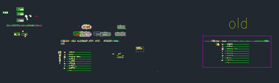

My screen shot shows two files. One has had my cleaning process and the other remained how it was received.

This removes about 4MB of file space and about 10,000  blocks in this particular drawing, it might be worth noting I exploded ~800 dimensions so about every dimension has 10 blocks inside of it. My next two screen shots shows the Audit dialog before and after purge (how many blocks I had before exploding and purging dimensions).
