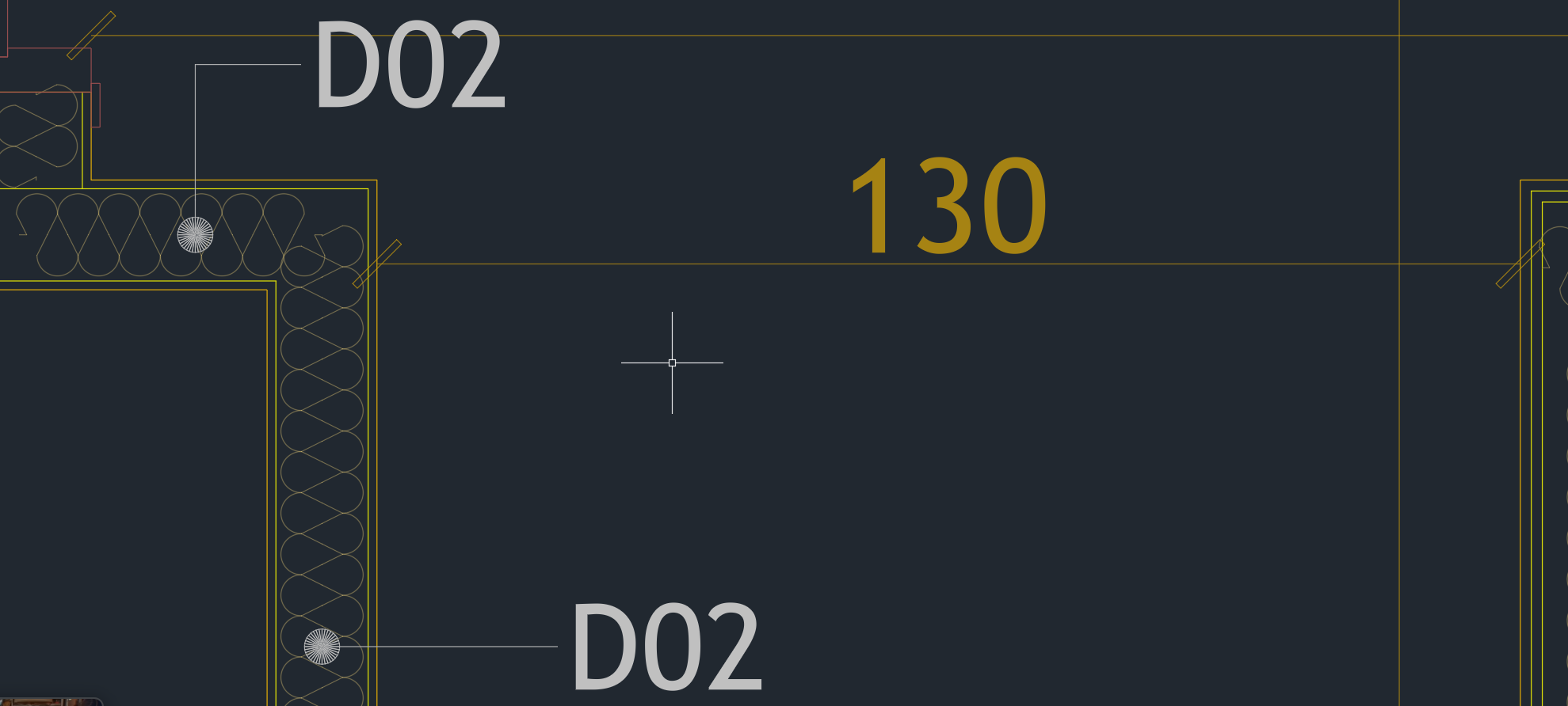

I dont know what happened but my dimensions and multileader style is different than they should be. When I copy them to new dwg file they looks normal, but here something happened. Can anyone help

Hello, can you share what version of AutoCAD this is?

I use AutoCAD 2026
imadHabash
There is a lot of reasons for your issue. But we need here a small part from your damaged drawing as a CAD dwg file for testing.
Try this:
Type UCS command then enter then then enter. Then type PLAN command then double enter. any changes?

Yes, it worked thank you so much
