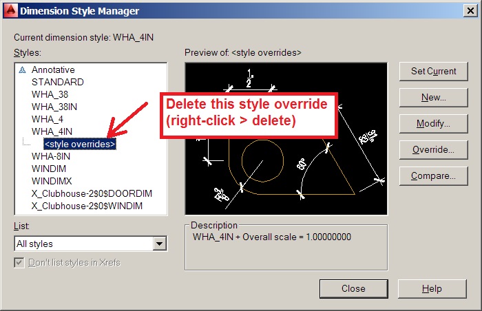

so I have a drawing that when i open it, without making any changes, my initial dimension string is miniture and not matching what the dimstyle says it shoudl be.  even when i "LIST" the dimstring or show "PROPERTIES" on the dimstring, it says it is a dim style that it is not.  the only way my dimensions will show up properly, is if i first select any other dimstyle, then reselect the style i wanted initially.
anyone know what is causing this and how to eliminate it from my drawing?  if i start a fresh blank drawing, i do not seem to have this issue.  it seems to be something embeded in my file.

>>...the only way my dimensions will show up properly, is if i first select any other dimstyle, then reselect the style i wanted initially. ...<<<
Those existing dimensions probably have overrides assigned to them. Post the DWG file if you suspect otherwise, but your description of the fix seems to fit.

I'm guessing its something embedded in the file, no idea what.  i tried purging but the goofy dim must be in a block or something because i dont see anything in the purge list that looks like it would affect.

Message 10 of 10
thank you Nestly & Pendean,
the issue seems to be resolved by going into my dimstyle manager and deleting a "style override" that appears under my dimstyle.  no idea how it got there, but somehting i can look out for now as i build on my file.
