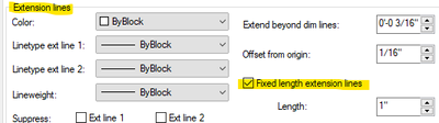

Or, don't turn off the Dimensions Layer, Move the Dimensions along with the wall, and they'll all still look normal, though in the new location.  [If you make them stupid, what would be the use of having them in their old location without the extension lines relating them to what is Dimensioned?]
Or, will this option in the Dimension Style definition help?
