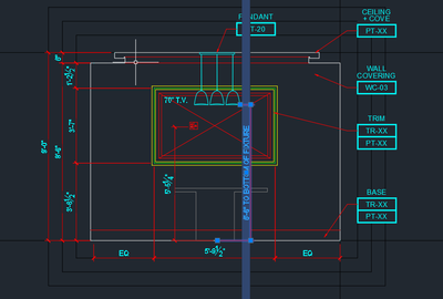

Hello AutoCAD Community!
(Background information: I am running AutoCAD LT 2018. All graphics drivers, etc. are up to date.)
I am running into an issue with my dimension text boxes. I have the dim. text box fill color set to background for my dimension style. This is working fine when my text boxes only contain dimensions. The issue I'm having is that when I add additional text to the dim. text boxes, the background color fill expands past where I have the text box limits set:
This happens even if I have the text box pulled in to only fit the text:
I'm not sure if I need to adjust something with my dimension style or maybe the tolerances? Any help would be appreciated!

Can you post a portion of your DWG file with that problem in place? I'm unable to replicate the issue in a quick test here.
Yes. I have saved this file separately so that you can see the properties. I am having this issue on many projects/ files, so hopefully it has to do with the properties rather than the file itself!
WarrenGeissler
This is an interesting bug. Your text style you are using in your dimstyle is set to a specific height (3"). Your DIMSTLE is set to a scale factor (32). While the text is showing up correctly, the program actually thinks it's 32x that size and is accounting for that with the background.
A temporary fix is to grab the line wrap in the text editor and pull it all the way closed:
A more permanent fix would be to use a text style with no height (0) and specify the PLOT height (3/32") in your dimension style.

Thank you so much!
The quick fix will work for now, but I will definitely look into our dimension style and fix it that way for future use.
