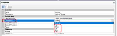

I have a very simple workspace that has a toolbar with a position that is not correctly saved. This was not a problem until I started switching workspaces and this toolbar would revert to the floating position when returning to this workspace. I would like to redefine the position of this toolbar from here:
2023-08-13 10_41_25-Autodesk AutoCAD 2015 - [20 El Prado [roof model].dwg].png
to here:
2023-08-13 10_41_40-Autodesk AutoCAD 2015 - [20 El Prado [roof model].dwg].png
as I look in the 'cui' dialog at the entry for this toolbar, it shows the default location as (1,1) and 'top' but there are no settings for being docked. I would like to lock this toolbar docked under the menu bar.

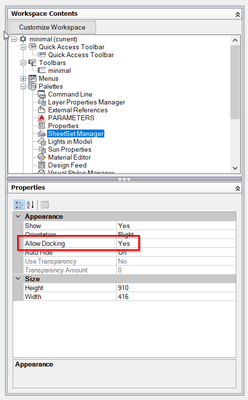

It seems like a basic configuration: I am surprised there is not a setting for docking toolbars as there is for palettes:
@Michiel.Valcke reason to save the cuix files is to reload on other machines or after a system restore. The CUI dialog seems so archaic that I have generally gone with the most basic operation of saving my 'minimal' workspace in the transfer tab 'customizations in new file' pane. Are you suggesting saving the workspace in a different way for use at a later time? I actually tried clicking the save buttons under the 'customizations in main file' and 'customizations in all files' panes but the button doesn't respond. Could this be how you are suggesting saving the main cuix?

Even if there's an "Allow Docking" option under Toolbars to match with Palettes (which each behave differently so there are different features to enable vs disable), this option just allows or prevents the user from docking it. What you're looking for is already there which is under Orientation. As long as Floating is not selected, any of the other options are supposed to dock the Toolbar.  Since in your case it's not staying docked where you last left it when switching to your Minimal workspace, then either there's a bug with the old AutoCAD version or there's a problem with your system. Perhaps you have access to another computer that has 2015 installed where you can test. Or try installing the latest 2024 version and see if the problem is resolved.
