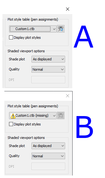

It sounds like your PC does not have access to the plot style (.ctb file), and the other PC does.
In the PAGESETUP dialog box, upper right corner, where you specify the plot style, does it look like (A) or (B) below?
