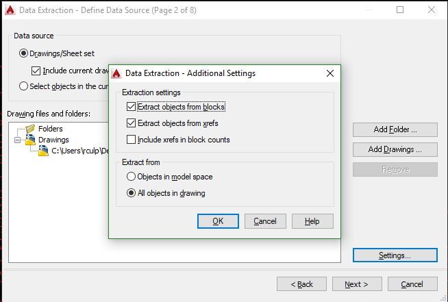

Data is extracted from all objects or just model space objects, you control that in the Settings dialog box on page 2
The DXE file created during the dataextraction is merely a method to save a particular set of dataextraction instructions for later retrieval and use.  Your end product output will be either a table in your drawing or a separate file or both, that separate file can be an Excel XLS file, a CSV file, am MDB file or a simple TXT file.  So you won't need any special applications to view/share the output.
Check the screencast below for a quick overlook at selecting specific data that is extracted and creating the output.  I output to both a drawing table and an XLS file in the screencast, see the XLS attached
