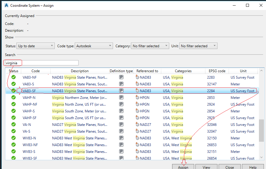

If using Map3D, then the workflow will be like this.
  1. Assign an appropriate coordinate system to modelspace. Since you are in Abemarle, you may use the coordinate system known as Virginia NAD83, South Zone, Feet. It is abbreviated as VA83-SF. See image-1.

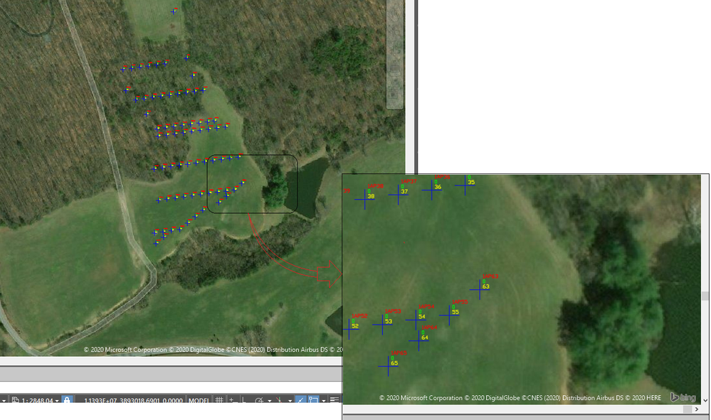

  2. Use MAPIMPORT and feed the 'List of Coordinates' that represents your stake positions. Prior to feeding your spreadsheet to Map3D, the xlsx is quickly formatted to PNEZD (or Point no., Northing, Easting, Z-value/elevation, Description). Then it is 'saved as' a csv file rather than an xlsx file because Map3d can't digest an xlsx but can digest csv. See image-2.
  3. Once imported, the points will appear as '+' signs or as blocks known as Map Survey Points. The labels, from top to bottom is Description, Z-value/elevation, and Point number. When Bing Aerial imagery is turned on, it appears accurately the background. See image-3.
  4. Finally, the DATAEXTRACTION command is used to pull out the x,y coordinates. The coordinates are not arbitrary, they are referenced against Virginia State Plane Coordinate System (SPCS), the same coordinate system assigned to modelspace in step 1. This command gathers the x,y coordinates of the stakes and puts them in an excel file saving you the time you spend doing it manually. Since the final list is in xlsx format, you can add info to the list if needed. See image-4.
