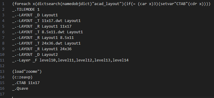

Message 25 of 25
paullimapa
If the zoom e in the vport is not always working that just means manipulating the "titleblock_x" layer should be not done at all. But instead just do a zoom extents which is what the zoome.lsp accomplishes.
But since you're adding more layouts each with their own vports from 8.5x11.dwt24x36.dwt then the script file should just run the lisp file's function zeavp which cycles through all layout vports doing the zoom extents command.
I also would not rely on what is placed in Startup Suites for Accoreconsole to load the zoome.lsp file properly.
Instead make sure zoome.lsp is located in one of the folders listed under AutoCAD's Options>Files>Support File Search Path & Trusted Locations. Then include the load lisp function in the script to load zoome.lsp and then execute.
Here's the updated script I'm now calling 11x17-3.scr
Line1: (foreach x(dictsearch(namedobjdict)"acad_layout")(if(= (car x)3)(setvar"CTAB"(cdr x))))
This is a series of lisp functions that activates all layouts by setting each current including Layout2
Line2: _.TILEMODE 1
This executes Tilemode and sets it to 1 so that the current tab is on Model FYI: This is same as: _.CTAB Model
Line3: _.-LAYOUT _D Layout1
This executes the command line version of Layout command to Delete Layout1 first before importing from template
Line4: _.-LAYOUT _T 11x17.dwt Layout1
This executes the command line version of Layout command again inserting from Template file 11x17.dwt  Layout1
Line5: _.-LAYOUT _R Layout1 11x17
This executes the command line version of Layout command again but this time Renames Layout1 to name of 11x17
Line6: _.-LAYOUT _T 8.5x11.dwt Layout1
This executes the command line version of Layout command again inserting from Template file 8.5x11.dwt  Layout1
Line7: _.-LAYOUT _R Layout1 8.5x11
This executes the command line version of Layout command again but this time Renames Layout1 to name of 8.5x11
Line8: _.-LAYOUT _T 24x36.dwt Layout1
This executes the command line version of Layout command again inserting from Template file 24x36.dwt  Layout1
Line9: _.-LAYOUT _R Layout1 24x36
This executes the command line version of Layout command again but this time Renames Layout1 to name of 24x36
Line10: _.-LAYOUT _D Layout2
This executes the command line version of Layout command this time to Delete Layout2
Line11: _.-Layer _F level10,level11,level12,level13,level14
This executes the Layer command and Freezes layers matching names: level10,level11,level12,level13,level14
Line12:
Empty line = Return which completes the Layer command
Line13: (load"zoome")
This performs the load lisp file function
Line14: (c:zeavp)
This runs the zeavp function
Line15: _.CTAB 11x17
This sets the current layout tab to 11x17
Line16: _.Qsave
This executes the Qsave command
Line17:
Empty line = Return which executes the previous last command
