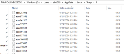

Message 16 of 25
abel_henok
Hey Paul,
Thanks for providing the additional scripts!
First, I would like to provide my steps to you just to be sure I executed your process correctly...the following were my steps:
1) Download, unzip and place .scr files in a trusted location.
2) Added the location of all files in a trusted location in AutoCad (11x17.dwt is located in the templates location and also in the location with the folder containg directory of .dwg files)
3) Appload DwgAccPikScrA.lsp and entered DwgAccPikScrA in command line
4) Selected the folder with directory of .dwg files
5) Selected and tested individually: 11x17.scr11x17-1.scr, 11x17-2.scr
All three scripts run as intended. I can see the commands in the .exe as shown in the image below:
However, I don't see any changes to the drawings in the directory. Notice the timestamps on the drawings below:
Though, I do notice files did populate in the temp folder with filetypes set to "file". Please see the image below:
Perhaps the script is not overwriting the existing files in the directory?
Please let me know your thoughts.
*Note: 11x17-2.scr works great on a single drawing when I enter script in the command line and select11x17-2.scr. It uses the dwt and also performs zoom extents.
Thanks again!
Message 17 of 25
paullimapa
That's because none of the scripts I gave you provided a QSAVE command at the end to save all the changes.
I've now added that which should now save the dwg before closing.
Let me know if 11x17-2.scr now properly zooms the vport location.
