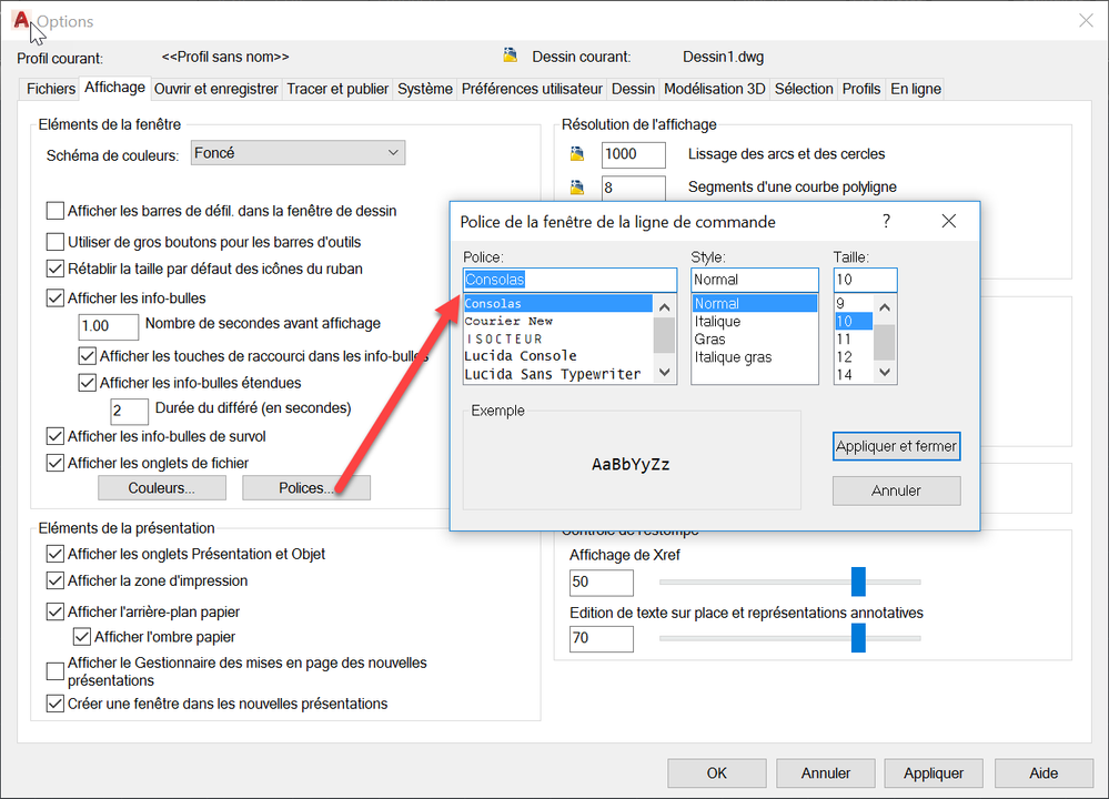

Hi everyone !
Fist sorry about my English... I'm french !
I'm having a problem with my new PC and autocad
DELL Windows 10, I7, 16 Go, x64, 3840x2160
When I work with autocad I have this :
I tried different versions (from 2013 to the last one), I tried an amtlib (worked for the top command line, but not for the bottom or the left), and I even changed my screen resolution to 1280x800, but Nothing worked !
Did some of you have the same problem ?
How did you resolve it ?
Thank you and have a great week-end !

Alfred.NESWADBA
if you have AutoCAD 2017 install the Update 1 (please don't mix it up with "Service Pack 1", that is something different.
You'll find the Update 1 when you start Autodesk Desktop App, make sure you are logged in and wait a bit (can be hours) until the next search for updates is done. You should then get a message that update(s) are available.
