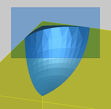

In this case, I have used LOFT to generate the surface of the corners:
Then, I have generated a solid from that surface with THICKEN to be subtracted from the rectangle.

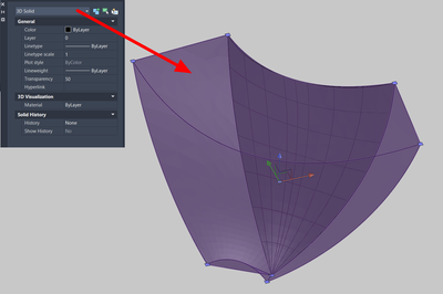

After making the subtraction, I must select the solid and change the "Record" menu to "None" to allow me to correct the detail easily.
Once changed, holding down the CTRL key, I select the area to correct; some red dots should appear.
Now selected it, with the delete key, you delete and correct the corner.
Since it is symmetrical, I have cut the model in half, and then the piece is joined with a mirror.
You will have a better chance of success than reaching a solid that becomes complex from surfaces.
