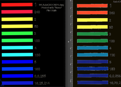

Hello folks,
I really need some help in trouble shooting where my issue would be from.
I cannot print a specified color to our printer to come out at least, very close to the chosen color from the computer.
Please see attached AutoCAD 2024 file to see if your printed result (paper copy) would look close enough. With my printer, none of the colors come close. The Canon technician took the Word file and their printer also did not print out correctly. Maybe it's in the way I assign the colors.

The AutoCAD file "04 AutoCAD 2024.dwg", has two True Color samples in there, "0,0,255" & "16,25,214".

leeminardi
Computer screens use the three additive primary colors of red, green, and blue whereas the subtractve primary colors mageta, yellow, and cyan are used to print on paper.
The conversion factors beween the two systems in not linear and very complex. The difficulty of the coversion from screen to printed paper is made even more complex due to the lack of color calibration of most computer screens and the need to use dithering (the digital equivalent of halftone) to adjust the intensity of primary colors used in printing.
I've changed the background color to black in your file to decrease the perception differences due to having a black vs. white backgrund. The screen colors are on the left and the printed pape colors are on the right.
Using a color picker the values for red, green, and blue for the two sets of index colors were recorded.  The Excel image below shows the results.
Column C show the result of using the color picker in the AutoCAD drawing file.  The RGB values are what they should be. Column D shows the result of the changes made in the process you used to captures the screen colors and save as a jpg file.  Jpg's include some compresssion so the color is not uniform throughout the rectangular area.  The varitation is more of an issue in column E that is the result of scanning a paper print and then savig as a jpg. The changes could be due to color deviations in your monitor or other factors.  Column G is the difference between the ideal color (column C) and the scanned jpg file color.  As can be seen the variation is all over the place due to the conversion from RGB to CYM (cyan, yellow, and magenta) and back.
High quality color printers are capable of matching screen colors to paper prints. Photographic techniques that work directly from a screen image provide good results too.  If you do not seek to create photorealistic prints but just want a line drawing with colors closer to what you see on the screen I suggest making a test file of different combinations of red, green, and blue and see how they print.  From those results you can swap the colors you use in your active file to get better results.  For example, since the AutoCAD red appears to print more with an orange tinge, I would replace red with a color with some blue to counter the excessive yellow used in printing.
