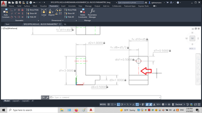

I'm trying to get one line to coincide with another on a drawing so it stretches when I change the dimension size but its not moving, it's acting like it's a fixed length line and I'm not sure why. I've tried tinkering around with it but nothings worked. Does anyone know what could be the reason for this? I've attached some screenshots of what I'm looking at to help.

Hi @ajehresmann,
It is kind of hard to tell what the problem is from just images, but I would guess it is over constrained, possibly from the constraints of a neighboring object.
If you want to post your file in the thread, and specify which line the issue is occurring with, we can take a look.

Hi @cheryl.buck thanks for getting back to me.
I was thinking it might be an over constraint issue too but when I opened the file today the line that wasn't acting how I expected it to started working like I thought it would and I'm not sure why, but maybe it was just a fluke glitch.
I'm not sure either still of how to get my annotations to respond parametrically like how to keep the center lines on the front of the hole when I change the dimensions. I've tried combing perpendicular and colinear constraints but that's not acting how I want it to and tried to add a tangent constraint but it won't let me cause then it says it'll be over constrained. I don't know if that's something you can help with but I'd appreciate any insight that could be offered.

Hi @ajehresmann,
Thank you for the file and screen shots. I apologize for my delay, I am generally only in the forums on Tuesdays.
I was able to check the file, and do not immediately see any conflicts between the constraints, but agree that adding tangents would over constrain it.
On the centerlines not showing in front of the hole, I don't believe I am seeing the same thing. However, I also may not be following precisely the same steps as you are when you see it. Can you provide a screen share showing the steps leading up to the issues?
One thing I can offer from my experience, is that when I encounter constraint conflicts or unexpected behavior, deleting and rebuilding the constraints often resolves the issue entirely. My suspicion is that I have accidentally left a constraint in, or constrained more lines than I intended in one.

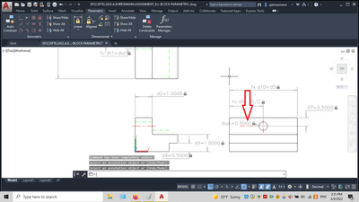

ajehresmann
Hi @cheryl.buck
Thanks for taking the time to look over my work.
I think my main problem got solved by just closing and reopening the file later which might've rebuilt it like you suggested.
The other problem I'm trying to figure out though is how to have both centerlines on a hole face move with the hole circle instead of one just staying in place and the other moving with the hole. They're both showing up just not moving parametrically like I want and I'm not sure how to constrain them so that they do. The other screencaps I gave show what I'm talking about but I attached a couple more here to hopefully clarify what I'm trying to fix.

>>Here<< a suggestion how to repair this issue (constrain the midpoints of both centerlines to the center point of the circle and constrain the lengthen of both centerlines).  ([EDIT]: corrupt link repaired)
I found a lot of other problems/missing constraints in your model. One of them (the most left vertical line) I also repaired in the video).

>>What I'd still do: <<  (My videos are without audio narration).
First I added a dimension d5. I think you only forgot it.
The only remaining "problems" are now the centerlines.
In the right view I'd suggest to use coincident constraints between the centerpoint of the circle and the midpoints of the centerlines. So they are always symmetrical to the circle.
I added a dimension d7 depending of the dia1 for their length and set the both to be equal length.
In the front view I added a dimension for the extension of the centerline. To get it symmetrical I added a vertical constraint between the midpoint of the center line and the midpoint of the edge above.
The same method (vertical constraint between two points) I used to fix the length of the centerline in the top view.
(Instead, i could have added 3 more dimensions for the extensions. But I prefer first to constrain as much as possible with geometrical constraints, and only the remaining with dimensional constraints).
