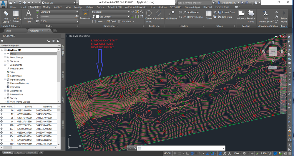

I have generated points as suggested by Dave, but it doesn't work.......here i have attached the generated random points data and screenshot......TEST1.pngTEST.png

Pointdump
Arbin,
OK, I see what you mean. The Surface Contours created from your new points doesn't match the Surface Contours created from the old points.
Contours are a representation of Surface Data, so different data (points) will produce different Contours. And the more widely the Points are spaced, the greater the difference.
Dave
