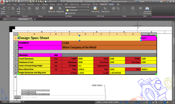

When you initially data link an Excel spreadsheet, the formatting comes from Excel. However, if you need to have your table (or even just specific cells in your table) look a certain way, don’t worry; you can define your own cell styles and select them individually, or as a group, and change any aspect of your cells with the convenient Table Cell contextual ribbon.
