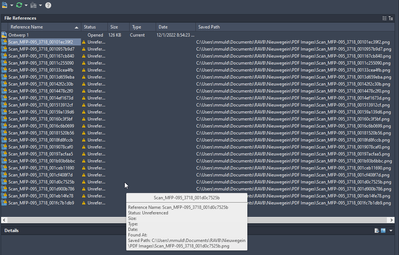

Your post file says there are 24 missing scans in it, did you just lose track of where those are, or did you actually have more content?
